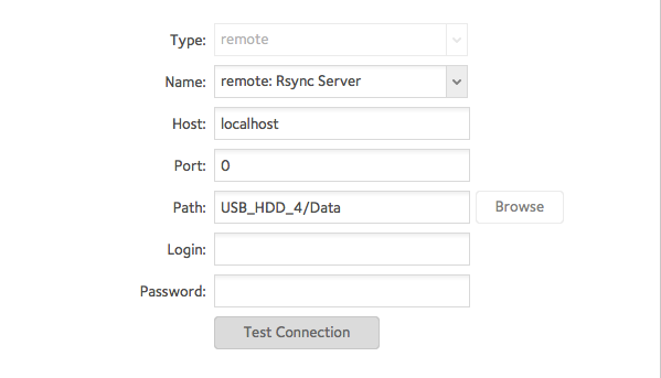

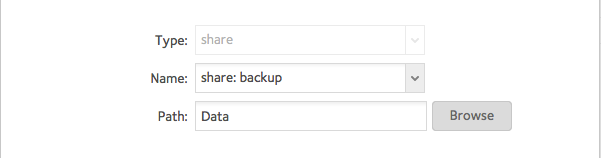

After upgrading to 6.9.2 I've noticed that rsync backup jobs that have a share subdirectory as a source don't seem to be running correctly. They complete almost immediately, nothing is copied, and the log has minimal info (see below). I've also looked at the processes running and it seems like rsync is actually never even executed. This appears to be similar to: https://community.netgear.com/t5/Using-your-ReadyNAS/Rsync-broken-since-6-7-1-amp-6-7-3/td-p/1291473 but since that thread is old I decided not to reopen it.
Backup Start Time: Mon Jan 29 2018 16:19:48
Backup Finish Time: Mon Jan 29 2018 16:19:48
Backup Status: Success
sending incremental file list
sent 59 bytes received 25 bytes 168.00 bytes/sec
total size is 0 speedup is 0.00

      I probably should have added a bit more detail. It's a local backup to USB using rsync and it's been working well for quite a long time now. Nothing has changed except for 6.9.1 and 6.9.2 updates. First upgrades in a long time.
      • StephenB's avatar
        StephenB
        Does anything change if you set the port to 873?
