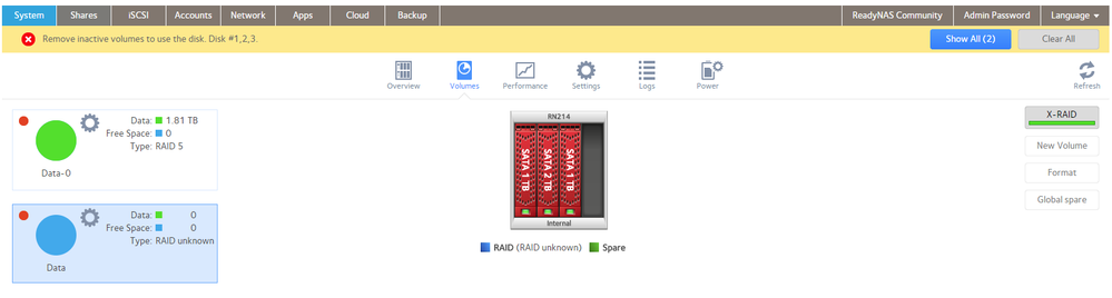

Encountered issue with 6.9.2
I've only had the RN214 for a few days, but everything has been going pretty well overall and I'm impressed with what I'm seeing over my VERY old windows home server.
When I got it up and running, it auto-updated to firmware 6.9.1. While triaging a seaparate case with a tech he suggested I update to the newest F/W, 6.9.2. Even though the device said it running the most current, I found the link and updated anyway. After reboot, all drives were in an inactive state and all of my data, shares, etc were gone. After some light troubleshooting, I decided to downgrade back to 6.9.1 and was relieved to find my shares and data still present -- although it did have to do a lengthy 3-hour rebalancing act -- but that was a small price to see my data again.
Not sure if I did something wrong (I can't imagine I did) or if there is an issue, edge case or something, but that was pretty bad. So heads-up I guess?

Can you send in your logs (see the Sending Logs link in my sig)?
- acraiglTutor
Done!
- mdgm-ntgrNETGEAR Employee Retired
Your logs show that the disk in slot 3 is bad. It's not a good idea to update the firmware with a bad disk installed.
If you look at smart_history.log you'll see that the WD10EADS disk you added has huge current pending sector, uncorrectable error and ATA error counts.
- acraiglTutor
Just for closure, I replaced the disk and upgraded to 6.9.2 with no issue. Thanks for the help.
