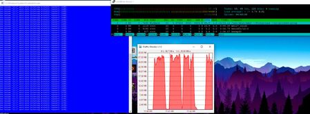

Hey guys, while WIndows wbadmin Backup i get the following problems, which leads to
- NO ACCESS to my File System while btrfs-transaction is on high load (Browser stuck / Explorer Stuck)

- Bruce2k18May 15, 2018Tutor
Problem startet in February 2018 (Where my last Update was made- but it should be daily)
I recognized the process failed after watching for something else in the windows report, and because of the old backup files.
Readynas
- FW: 6.9.3
- dust freed
Data Volume:
- 4 x 1 TB WD Red something which is to use with this NAS . i checked tripple
- XRAID
- data 1,39 TB
- Snapshots: 516.28 GB
- Free Space: 838.51 GB
- Total ~ 2,73 TB
- Type: Raid 5
-TRIED STUFF-
* switch off Bit-Rot from every share
* defrag
* delete snapshots
* switch samba protocols (smb 2 /3 ) ((installed samba plus for that)
* scrubing
* new users
* iperf (works great)
* write I/O internal 54 MB/s
* write from Network 29 MB/s
* read from Network 55MB/s
-> wbadmin backup stream ~ 240 GB
Trying at the moment:
* balancing
process which takes 100% load "brtfs-transacti "
why a transaction on the file system stopps the whole samba process by sucking away the power ?
-> Priority?
Hope I could feed you with Infos.
PC:
Intel i5 somewhat
Network works great to other devices
The SambaProcess slows and fastens by occupied and free cpu % power
Can someone stabilize this **bleep** ?
-> Controlling Application Consumption
Sorry I am an intermediate linux user / advanced windows user - but when you use a Marvel ARM Board with 1,2 GHz then optimize it. Every process going wild at that thing.
