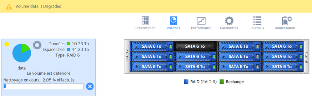

- techniqueDec 23, 2022Aspirant
Hi.
The nas was completly unresponding and the download off logs never works. The reboot doesn't work too.
After the disk replacement the logs download works. Now the volume is degraded and run a clean.
