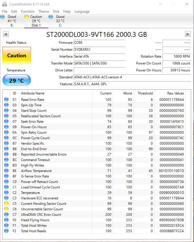

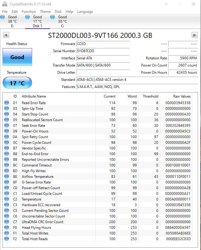

The day the system failed, we had construction workers using a shaker/vibrator compacting soil-backfill for the road right next to our house for hours (30 feet from the NAS in the basement).
So, I though I first check if the two disks that were spinning in the NAS at the time took any damage.
I did a SMART check on the disks and have attached the analysis below. Looks like disk 1 is about to fail or has failed already but then disk 2 should have taken over, right? Is the Ready NAS OS only on disk 1? Will it be written to disk 2 if I only insert the original disk 2? Seems that disk 2 is still OK (and the NAS did a full synchronization the day before it failed).
I also found out that the questionable NAS is not questionable at all. I inserted one blank disk (not even from a NAS) into it and it worked fine. I also inserted two disks (X-RAID) taken of another Ready NAS Duo v1 and it worked fine.
I also made sure the the both Ready NAS Duo I have are on same firmware 4.1.16.
Shall I still proceed in the way you recommended?
