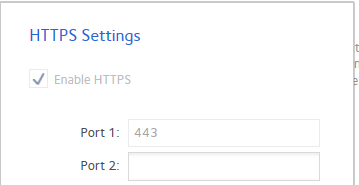

I have also checked other settings and they all look OK. The services show HTTP and HTTPS off, eveything else on.

HTTP and HTTPS should be turned on in system->settings->services.
Where were you looking?
- LeapingLemmingMay 06, 2019Tutor
Exactly where you say and I can't turn them on for some reason. I click on them and the pop-up has all options greyed out.
FYI as for network settings, IP4 has a static IP, IP6 is disabled.
And they have no green stripe going through them?
Of course you can reach the NAS admin, so one of them has to be working.
- LeapingLemmingMay 07, 2019Tutor
No green stripe through HTTP or HTTPSSee above, no green stripe through either ... and yes I get to NAS admin, but HTTPS must be working because even though greyed, it is 'ticked' as on
Also got desperate and removed then rediscovered the device. No luck there either.
