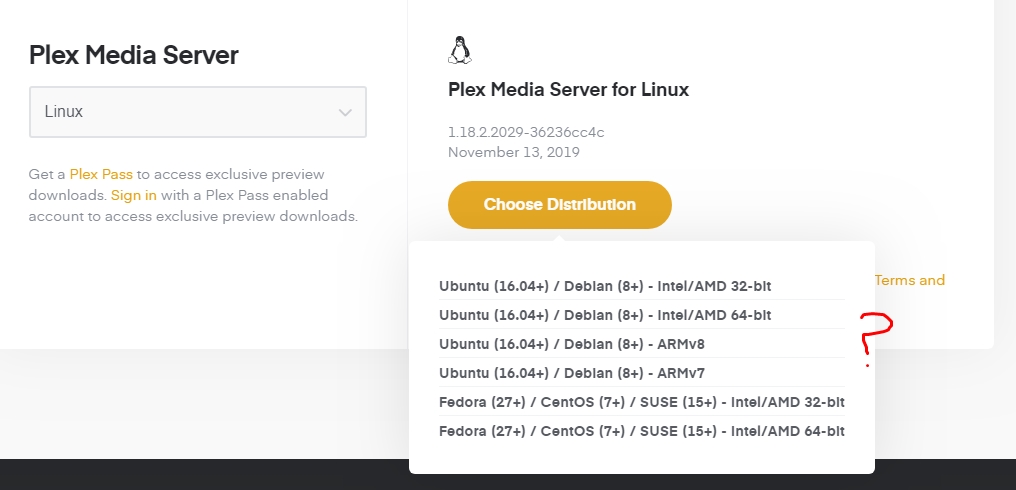

I see that Plex addon can be installed but when i goto Plex download page i have two possible options...
1. Netgear
2. Linux
if i choose to download for Netgear Nas, i only get a x64 version (but nas is x86 right ?)
if i choose Linux i do see a X86 version.... is this the one i should choose (Linux - Ubuntu or Fedora , which ??) and not (Netgear) as one would expect to choose ?
https://i.postimg.cc/bJ0GwK5f/plex-netgear.jpg
https://i.postimg.cc/90WDRL3R/plex-linux.jpg
thanks

Choose Netgear(not Linux) at https://www.plex.tv/media-server-downloads/ and then select the 64-bit Intel package. The download will end with .amd64.deb.
- Marc_VNETGEAR Employee Retired
Welcome to the Community!
You can select NETGEAR X86 refers to the family of processors (Intel,AMD) while x64 is the current computer architecture which is 64-Bit. Most Intel and AMD processors now supports 32 and 64 bit
The NETGEAR Package for 64 Bit is .deb which is an extension for Linux Debian which ReadyNAS uses.
HTH
