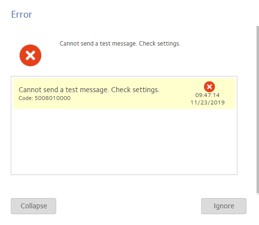

- xlr8rNov 23, 2019Luminary
ive tried every possible combination in email settings and always get an error?
https://i.postimg.cc/FRbB3Qtv/nas-email-error.jpg
i cant understand why these setting worked before the upgrade and now dont, clearly the new OS is the issue ,,,,
- StephenBNov 23, 2019Guru - Experienced User

I posted the settings that you should use (from the BT website):
Outgoing Mail Server: mail.btinternet.com
Port: 465
SSL Encryption: Enabled (but not STARTTLS)
Authentication: PLAIN
Username: your email address including the @btinternet or @btopenworld.com part
Password: your btinternet or btopenworld password

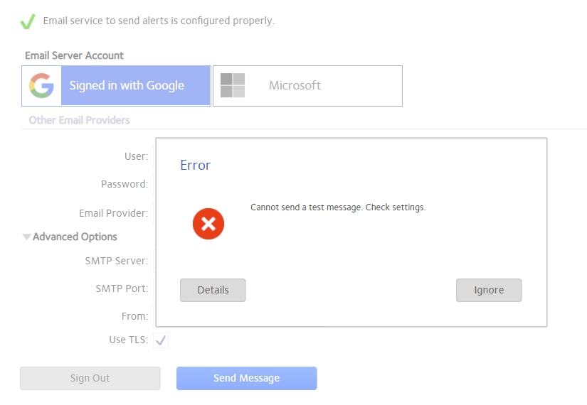

- xlr8rNov 26, 2019Luminary
i have identical settings but still refuses to send the test email...
i am at a complete loss as to whats stopping it... ?
https://i.postimg.cc/C1LdNsz2/gmail.jpg
in your Nas network settings IPv4, what do you have under DNS ? Just router IP , like 192.168.2.1 and no other DNS values ?
from the logs , i see this;
Nov 26 13:15:09 host=smtp.gmail.com tls=on auth=on user=******@gmail.com from=******@gmail.com recipients=NAS @*****@gmail.com,******@gmail.com smtpstatus=553 smtpmsg='553-5.1.2 The recipient address <NAS @*****@gmail.com> is not a valid RFC-5321\n553 5.1.2 address. z2sm15073313wrs.89 - gsmtp' errormsg='recipient address NAS @******@gmail.com not accepted by the server' exitcode=EX_DATAERR

- StephenBNov 26, 2019Guru - Experienced User
I have ipv6 disabled in the NAS, as I don't use it on my home network. IPv4 uses my router for the DNS server (which is 10.0.0.1). The router in turn uses my ISP's DNS server, followed by CloudFlare (1.1.1.1) and Google (8.8.8.8).
But it's clear from your log snippet that you don't have a DNS issue. The mail client in the NAS is clearly reaching the SMTP server, and that server is rejecting the email.
xlr8r wrote:
...The recipient address <NAS @*****@gmail.com> is not a valid RFC-5321/n553 5.1.2 address ...
This appears to be the real problem. FWIW, in my case the two email fields (user and from) are both identical, and they both are just the email address of the gmail account I am using. If you are doing something different there, then try what I am doing.
If you like, you can also send me a private message with the full screen shot (so I can see what email address you are actually using). Up to you of course.
