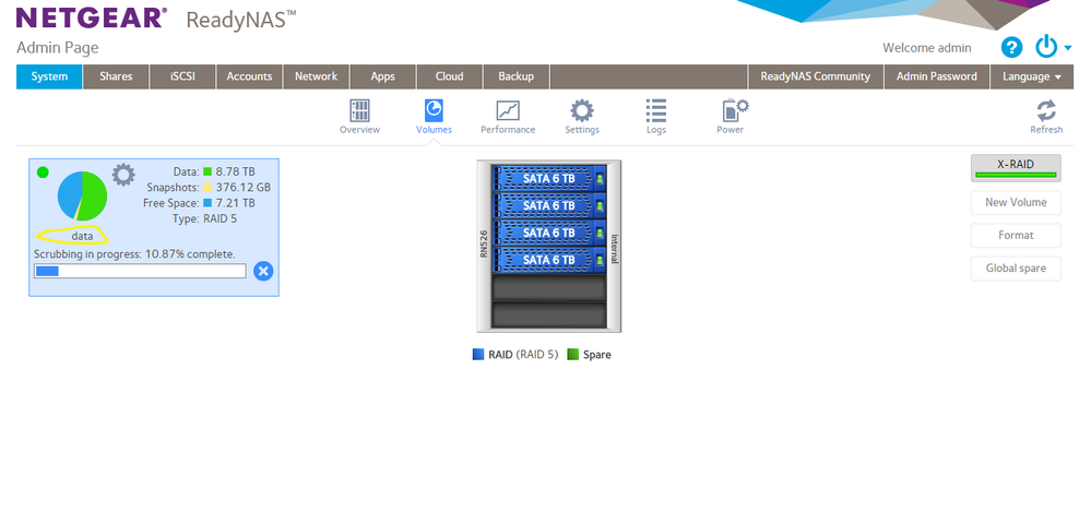

i assume when you say volume it's the name i have given the NAS as it would appear in WE?
NO. It's the name of the RAID volume. You see that on the volumes tab of the web ui. If you did the usual setup it is called data.

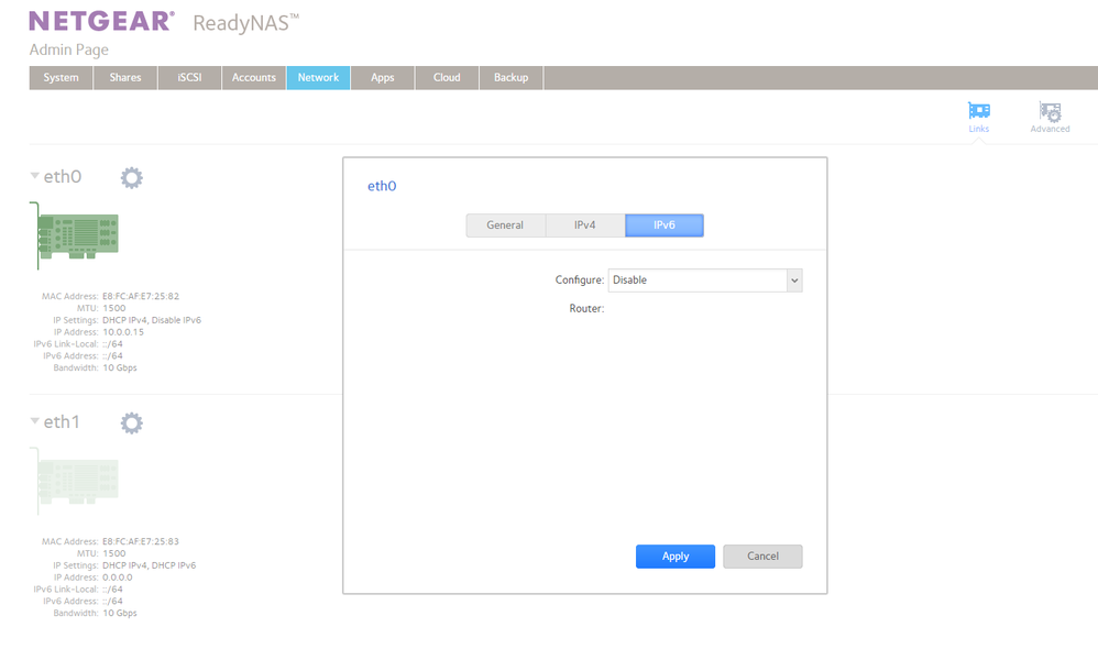

Another thing to do is to go into the ReadyNAS network settings and disable IPv6.

The volume is called data so i tried t: \\nas-ip-address\data /user:admin nas-admin-password and this time it responded with "The system cannot find the drive specified".

The netowrk connection is set to Private and i have disbled IPV6. No change in cmd when i try again.
