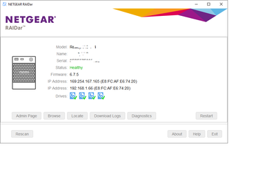

RAIDar much like Readycloud can see the device and can even browse but not access it. It two reports two IP addresses, the device was originally set up to combine both ports to one address! After some time it eventually downloaded the logs :

My guess is that the 192 address is valid, and the 169 address is not. You might want to disconnect the NIC that is using the 169 address.
Thanks for the suggestion I have been down that road with the crossover cable but I'll give this a try again.
I'm not sure how the crossover relates, but the NAS auto-detects, so a crossover isn't needed.
