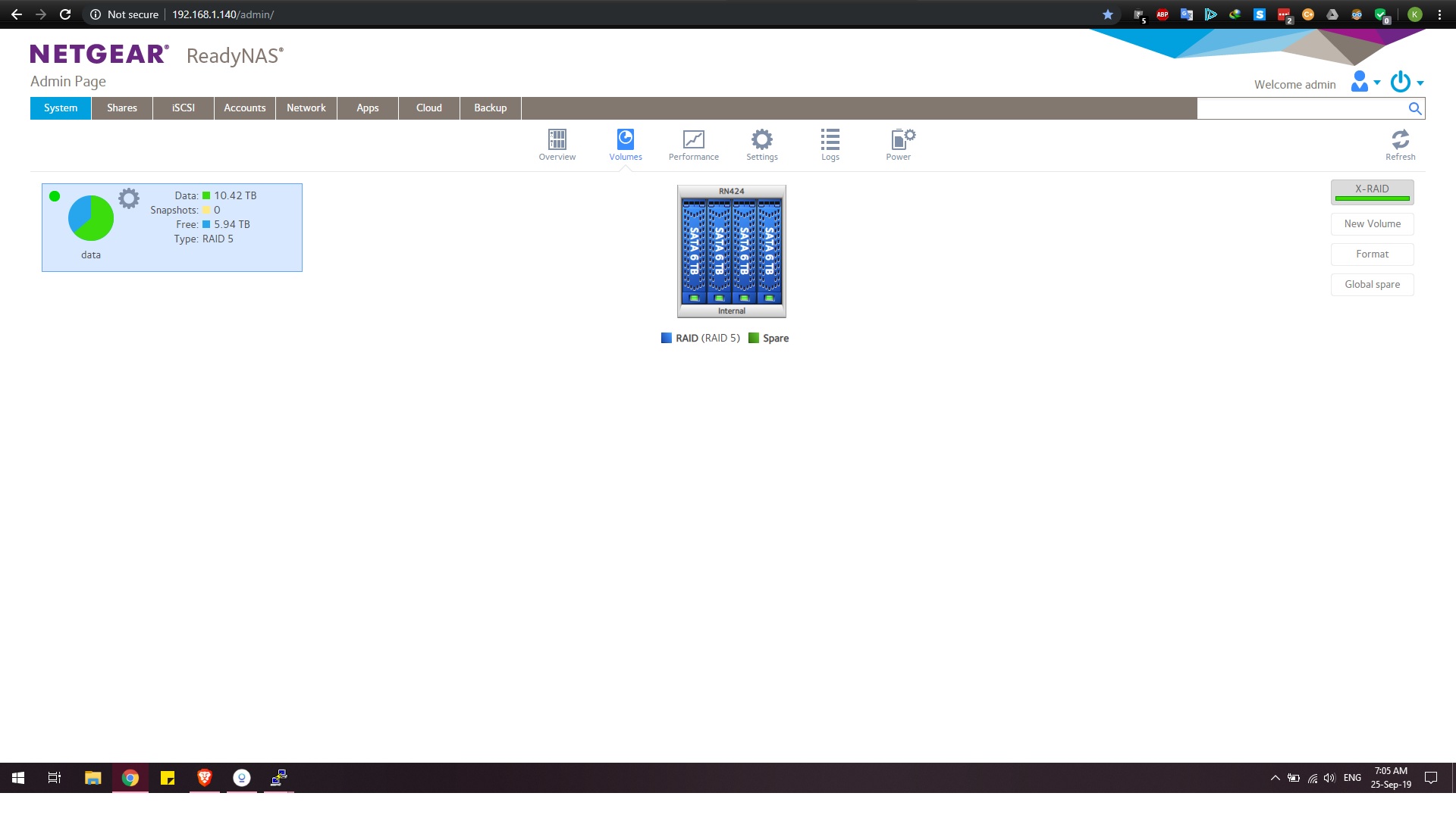

Unable to erase inaccessible snapshots in ReadyNAS 424
Hi, I have a ReadyNAS 424 and even after I have disabled and deleted all the snapshots in it. But still 1-1.5 TB s space is alloted to it. I have tried the methos from, https://forum1.netgear.com/t...

OMG Finally!!! It works! All the snapshot allocation is cleared! Thank you so much! Now running a balance operation.

And finally the snapshot allocation was cleared. I will post the web UI page screenshot again after completion of the Balance operation. Again thank you so much!
