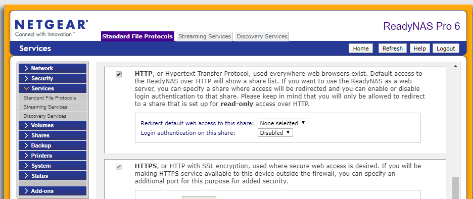

  • Also, I suggested enabling HTTP for the share.
    Click on the services on the left, and then "Standard File Protocols".  Scroll down until you see HTTP.  Make sure it is checked, and that the redirect is set to "none selected", and login authentication is set to "disabled" as shown below.  Then click apply.

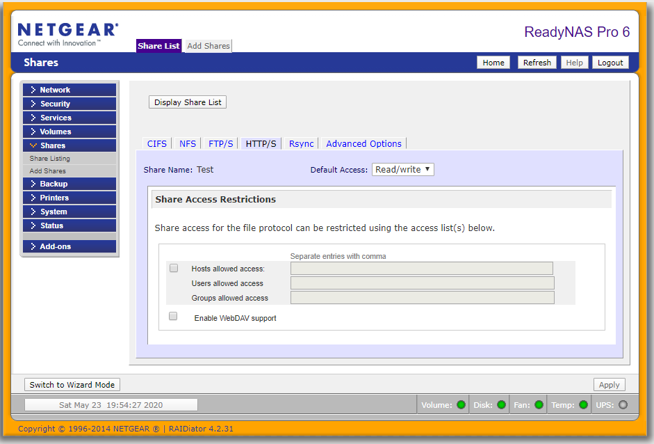

    Click on "Shares" again (then Share Listing), and click on the http/s icon for the Primary share. You should see this
    Set Default Access to Read/write, and then click apply again.
    After this, you will hopefully be able to access your files with Windows Explorer.
    If that fails, also try to browse to http://192.168.0.142/Primary
    You should also see the files there - if you do, then try to download one of them, and see if that works.
