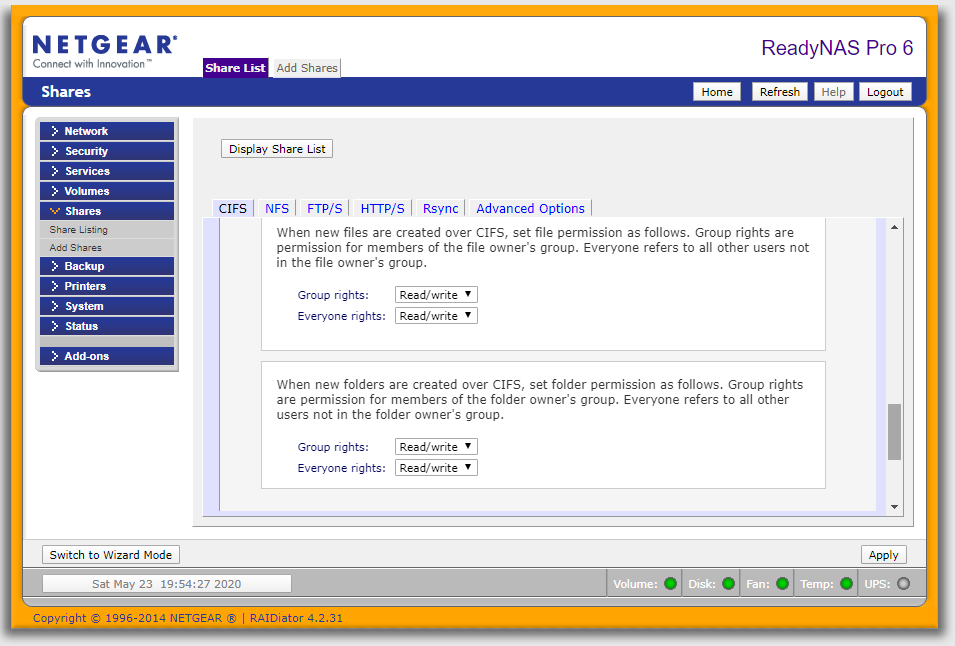

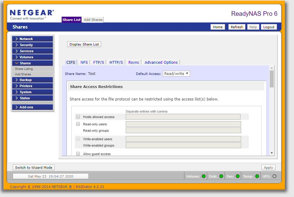

First click on the shares tab on the left pane, then then click on the CIFs icon next to the Primary share.
Make sure the Default Access pulldown (top right) is set to "read/write". Scroll down to "advanced CIFS permissions", and set the two check boxes and the two file pulldowns as shown below:
Scroll down just a bit further, and make sure the two folder settings are also set the same way:

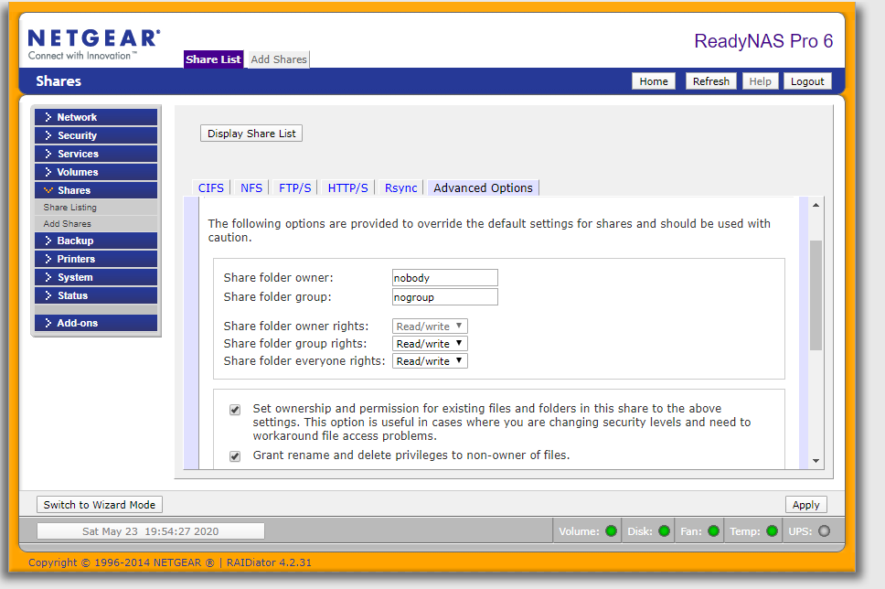

Now click "apply" on the bottom right. Next click on the Advanced Options tab on the top of the screen.
Set the owner to nobody, and the group to nogroup. The three rights pulldowns should all be set to read/rewrite. Check the two checkboxes below that as shown:
When that's all set up as shown, click "apply" again on the lower right. The "set ownership and permission" checkbox will clear - that is normal. After a little while you should see a pop-up telling you that the permissions have been reset.
