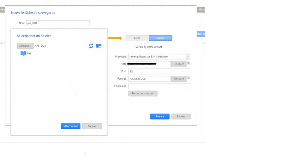

Yes the destination in remote
When I click "Browse", it first ask me "Connect As :"
Here I have to put the user I creat on the remote nas associate with the SSH key (and this step work)
Then I have a 2nd windows "choose a folder"
but the only line in that liste is "root" (and I have no root share anywhere"
and I can't select that line
And when I click on "Select" buton nothing happen (probably because nothing is selected"
There is also a button to creat new folder on that page, that give me an error message to select a parent folder node first

- AranolAug 27, 2018Aspirant
This is the screen I have after clicking on "browse"
If I don't use it, and use the "test conection", I've got an error message "impossible connection with host"
