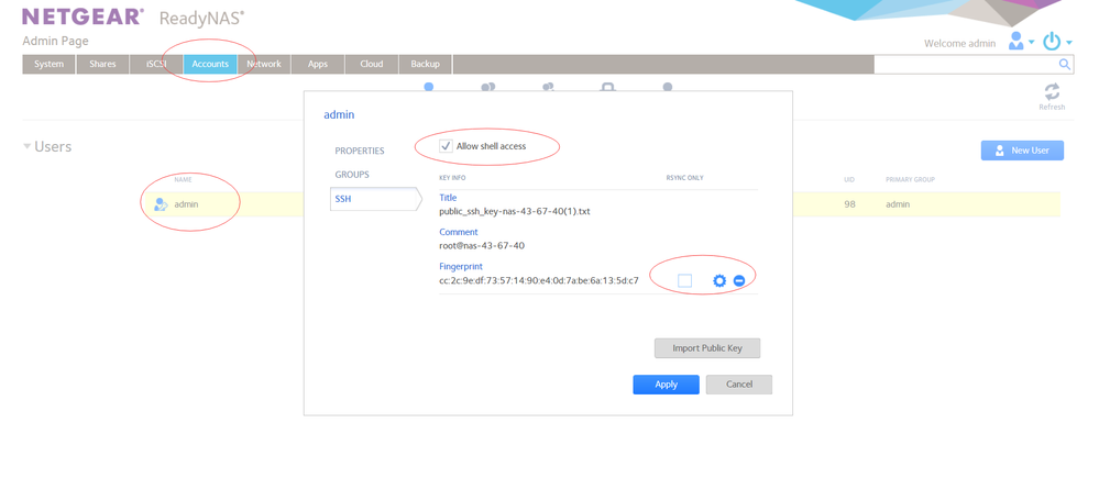

    Have you solved your problem? You can try this method, as shown in the figure: checked "Allow shell access" and unchecked "rsyc only" option.
