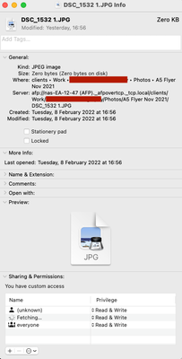

Zero Bytes after a few seconds
We've been receiving a strange zero bytes issue when saving files. We are running a few iMacs on the network, it's a mix machines running MacOS Monterey down to High Sierra. We can save a varie...

Is there any particular log that I should concentrate on. i.e. system.log (system log only has todays events).
Smart Log suggests a load of sector re-writes back in December, but nothing for yesterday (when we last experienced zero bytes)
Does your hunch suggest that it is a disk I/O issue that would cause this? it was a mild issue a year ago after an upgrade to the latest firmware, so we rolled back it was still happening. We then thought that Samba was causing it due to one mac being upgraded to the latest MacOS a few weeks prior, so we switched to AFP and it was rarely happening. However its become rife at the moment. I'll order 2 HD's for now. maybe order another if we still have the issue as disk 3 is reallocating successfully and theoretically that shouldnt be causing so many issues. Disk 2 is my primary concern as the errors suggest failure soon.
