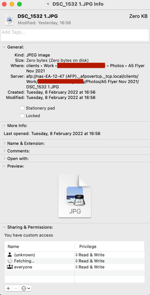

Zero Bytes after a few seconds
We've been receiving a strange zero bytes issue when saving files. We are running a few iMacs on the network, it's a mix machines running MacOS Monterey down to High Sierra. We can save a varie...
