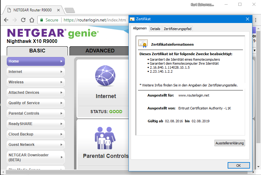

    To the extent I think I understand Chinese your R9000 has a certificate with an expiration date in 1902. No idea what can cause this - seen at least one more similar report some days ago here in the community.
    The Nighthawk firmware does usually come with a factory (hard coded) certificate, signed by Entrust, that's the one I have in place since 1.0.3.10 - conclude, there is a problem with some, but by far not all R9000 updated:
    This kind of factory certificate is also the reason why older firmware - which held indeed an expired certificate (but not back as far as 1902) - can't be used anymore.

    If you have a minute - please download the OpenVPN Windows config from your R9000, unzip, and open (double click) ca.crt and client.crt - post the certificate overview and details.
    The older certificate set was valid from 25-APR-2014 ... 22-APR-2024, the one I have here on my R9000 is valid from 26-APR-2017 to 21-APR-2037. Curious about yours.
