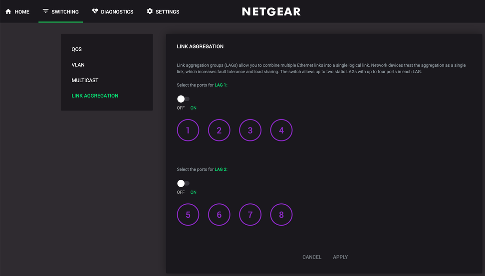

To be fair, there isn't much available option-wise in the GUI. Just LAG1 (Choose from 1,2,3,4 port) LAG2 (Choose from 5,6,7,8). and a toggle bar to choose which one. In my case I had chosen LAG2 (Port 7 and Port 8 ) and toggled the little button to "green".
This does reflect the two LAGs which can be defined, For LAG1 from the ports 1..4, and for the LAG2 from the ports 5..8. The green indicators just show the enabled state.

Would you be willing to help in setting LAG correctly on this switch, suppose it would be Static Aggregation now. To be fair, there isn't much available option-wise in the GUI. Just LAG1 (Choose from 1,2,3,4 port) LAG2 (Choose from 5,6,7,8).
From your exp, is there anything I may have overlooked?

All the GS305E and GS308E Data Sheet show "Number of Static Manual LAGs and # of members: GS305E N/A GS308E N/A".
All the GS305EP GS305EPP GS308EP GS308EPP GS316E GS316EPP Data Sheet does show "Number of Static Manual LAGs and # of members: GS305EP 2/4 GS305EPP 2/4 GS308EP 2/4 GS308EPP 2/4 GS316EP 8/8 GS316EPP 8/8"
This is what confused me, because I know from the chip set specs (as reflected in the GS305EPP and GS308WP/EPP) the five and eight port do support static LAG - and how ever, this is missing or went lost in the product spec and definition process. his is why I tried to bring some attention to NTGR
