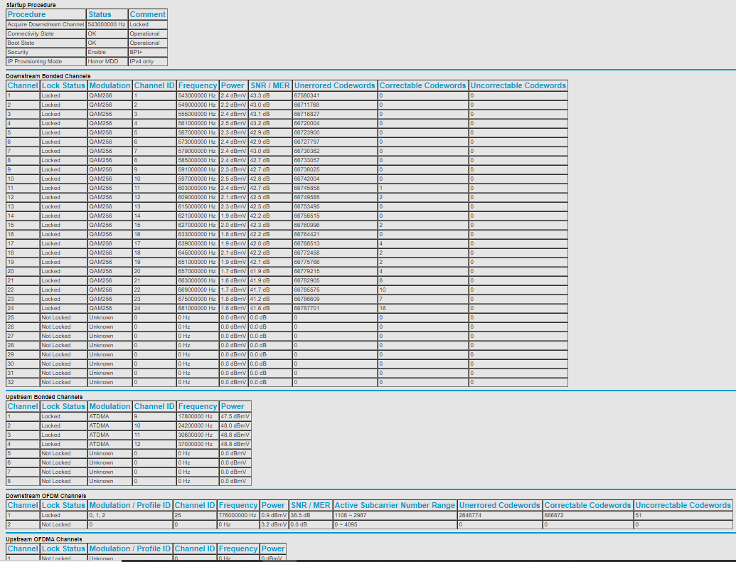

Awesome, so after setting up our new CM1000 (v2) I ran the 1mS/1Min test again via PingPlotter to www.google.com.
I am no longer seeing those 200mS spikes; jitter is ~10-20mS and remains this way.
However, after setting it up on my lunch break and returning home to check out the log; I noticed each channel had ~>100 UnCorrectables and 100-500 Correctables.
My US Power levels for each of the 4 channels was 50dBmV (I'd be much more comfortable with ~45dBmV.
Attached is my Modem Log following reboot ~30min ago.
(I had to modify some of the HTML/delete elements/reduce fontSize in order to get DS and US to be displayed in one snapshot.)
Not sure why this new FW has such a buggy GUI for displaying Cable Connection Stats..
Anyway, I'll play around with this new modem a bit and maybe inspect my coax for any ingress/coupled noise sources if I have T3's down the road. Thanks for your help again, @FURRYe38

Here are some details/stats.
NO ATTENUATION:
_________________________
Downstream:
My DS PWR Level for Channels 1-24 range from +2.4 to +3.5 dBmV.
SNR/MER Range = 41.4 to 43.1dB
The following stats are from 50 Hours of UpTime with ~3.85E9 UnErrored CodeWords/Channel:
Correctables range from 500-2500(as frequency increases, Correctables INCREASE)
UnCorrectables range from 400-600(as frequency increases, UnCorrectables DECREASE)
Upstream:
PWR Levels:
46.8 dBmV
47.0 dBmV
48.0 dBmV
48.0 dBmV
_____________________________________
WITH ATTENUATION:
Downstream:
My DS PWR Level for Channels 1-24 range from -0.8dBmV to +0.0dBmV.
SNR/MER Range = 42.0 to 43.5dBmV.
The following stats are from 18 Hours of UpTime with ~2.87E9 UnErrored CodeWords/Channel:
Correctables range from 13-378 (as frequency increases, Correctables INCREASE)
UnCorrectables range from 62-98 (seemingly no correlation with deltaFrequency)
Upstream:
PWR Levels:
49.8 dBmV
50.3 dBmV
51.3dBmV
51.3 dBmV
I would copy/paste my logs, but all I have are screenshots of the old log, split between 2 separate images.
I noticed that WITHOUT the -3.5dB drop, my DS levels were all ~ +3.5dBmV, so a 3.5dB drop here would be perfect to hit unity. But as I expected, installing the splitter brought my (Already borderline HIGH) US levels From ~47.5dBmV up to ~ 50dBmV. I vaguely remember reading specs for the CM1000 indicating it was capable of ~54dBmV. This may be standard for all Modems, but still.
So based on the trade-offs described above.. would I be better off WITH or WITHOUT the splitter? Thoughts? Concerns?
I’ve noticed no differences in Download/Upload speeds via Speedtest.net.

I noticed that my Correctables/unCorrectables were still reaching >1,000 / channel within 24-48 hours following CM1000 install.
My US Power levels were typically ~47dBmV/channel and were periodically maxing out and causing T3/T4’s just like before.
Adding a splitter to attenuate any potential noise at the drop did not change my SNR/MER levels much, they remained 39-43.
So I bought a female-female adapter that had terminals for proper grounding. So I connected the drop directly to my coax line upstairs where my modem is connected (just like before) but this time with proper grounding. - NO CHANGE -
I researched a bit and ended up buying a 100ft Quad Shielded Coax from Amazon so I could run this temporarily from the drop to my modem upstairs. If this worked well and problems went away, I would know that my coax in the walls is the Root Cause.
Here’s the cable I bought:
100ft Weather Seal Quad Shield Outdoor 3GHZ RG-6 Coaxial Cable 75 Ohm (Satellite TV or Broadband Internet) Anti Corrosion Brass Connector RG6 Fittings Assembled in USA by PHAT Satellite INTL
https://www.amazon.com/dp/B01GBX8HIG/ref=cm_sw_r_cp_api_i_5HENEbFNQ5AMD
Unfortunately, ~113 hours of UpTime, and each Channel has >2,000 correctables/unCorrectables just like before.
Adding the splitter in series with this new cable causes the US to increase to max and cause T3/T4’s as well.
So this means that the Root Cause must be somewhere on Spectrum’s end. Whether it be someone in the neighborhood introducing noise, an issue at the node or something else.
I feel better having ruled out issues on my end, and I don’t expect this to be resolved in a timely manner, as is no surprise I’m sure based on TimeWarner/Spectrum’s history with resolving these types of issues.
Just for fun/reference I will include a capture of my log today. I’ve been taking a screenshot of my log/cable connection every day, so I have the daily history too which may come in handy.
Let me know if you notice anything I missed!

I would have a tech come onsite and you can show him and he can test while your there. I would ask him to put on a different modem to test as well.
