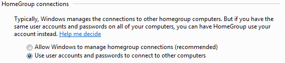

Good info Ian... However in 32 bit Win7 I didn't need to go as far as your link suggested (which really leaves your system quite wide open), nor did I have to remove Live ID Sign-In Assistant, probably because I refused everything when I installed Messenger.
I think that the key to getting sharing to work for access from the NAS is this setting:
