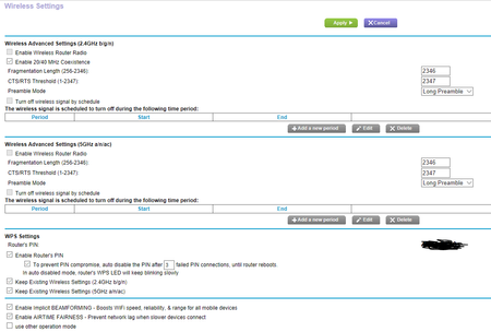

Nighthawk R6700 I was updating moved my router to a higher point and for some reason I no longer have WiFi. I pressed and hold the button on the front of the unit but nothing happens. When I go to the GUI page, the basic page shows the "Wireless -> OFF". Any suggestion on how to turn it back on? When I click on that it takes me to the "Wireless Settings" page and the "Eanble Wireless Router Radio" is disabled and grey. I am unable to check it. This applies to the 2.4GHz and 5GHz as you can see below. Nighthawk R6700 Hardware Version R6700 Firmware Version V1.0.0.26_10.0.26 GUI Language Version V1.0.0.26_2.1.38.1Solved5.3KViews0likes3CommentsProblem setting up AC1750 R6400 as a bridge to an AC 1750 R6400 primary/modem router
