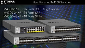

We’re pleased to announce new options for your next fully managed switch deployments in the M4300 product line. The M4300 Stackable L3 Managed Switch Series comes with 40G, 10G and 1G models in a variety of form factors including PoE+ full provisioning. M4300 Switch Series delivers IPv4/IPv6 rich services for mid-enterprise edge and SMB core with mixed stacking between 40-, 10 and 1-Gigabit models. Layer 3 feature set includes static and policy-based routing, RIP, VRRP, OSPF, and PIM dynamic routing. M4300 is ideal for server aggregation, wireless access, unified communications and Video-over-IP. New 10GB Copper Switch with PoE+ M4300-16X (XSM4316PA and XSM4316PB) - Two options of Half-Width 16 Copper 10G Ports Managed Switch with PoE+. 2 Power supply options with 199W or-500W PoE+ total PoE Budget and 480Gbps switching fabric. A perfect managed switch option for small AV-over-IP deployments server access and IT top of rack deployments and more. View the M4300-16X datasheet. New Full Fiber M4300 Switches M4300-24FX (XSM4324FS) - Half-Width Switch with 24 Ports all fiber 10G SFP+ ports. A great switch choice for medium sized AV-over-IP deployments or IT top-of-rack requiring SFP+ fiber aggregation or direct server access. View the M4300-24FX Datasheet. M4300-48FX (XSM4348FS) - Full-Width Switch with 48 Ports all fiber 10G SFP+ ports. A great switch choice for medium/large AV-over-IP Deployments or IT top-of-rack requiring SFP+ fiber aggregation or direct server access. View the M4300-48FX Datasheet. We would be very interested to hear how you plan to use these new switch offerings from NETGEAR Business.4KViews2likes0Comments#Webinar - Embrace Next Gen Switching with 10g PoE and AVoIP Capabilities - M4300
