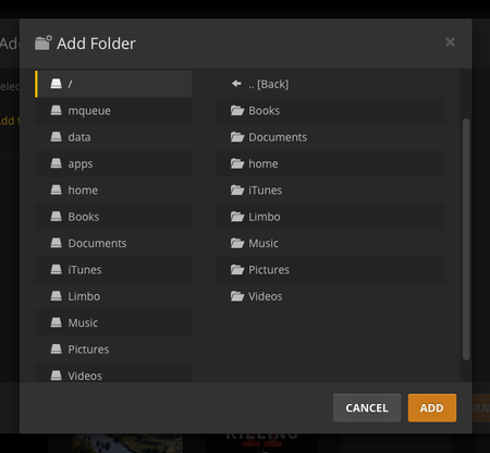

Depending on which icon I click when adding folders to my Plex libraries using its server GUI, the initial folder path is either /var/ftp or /data. See the screenshot below: For example, per the screenshot, adding "Films" through the icon in the left pane of the file tree adds the folder at path var/ftp/Films, whereas clicking on the icon in the right pane of the file tree adds the folder at path data/Films. They're both the same folder. Is there any any difference to either of these methods other than the obvious? Is one method recommended over the other?SolvedReadyNAS 104 wont install any apps FW 6.5.2 (and also 6.6.0)

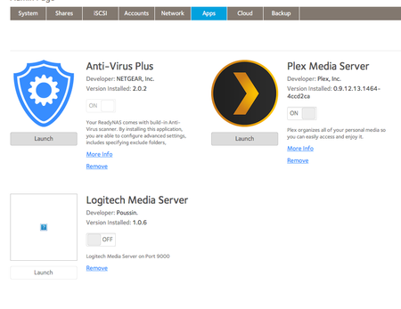

After upgrading to 6.4.0, Logitech Media Server got slightly borked. The app icon is no longer displaying, the app is permanently listed as "off" (see the screenshot), and yet—thankfully—it's still running. Is there an update to the app that works more reliably with the current OS6? (It was developed by s-p, if I have his new username right.)4.8KViews0likes6CommentsPlex and my readynas 102 and access
