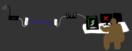

Right so i have a spicy issue that i cant get my head around and i very much hope a or a multiple of beautiful souls here can help me out with! So lemme throw some deets down! I have some Cameras that hook up to my R7800 via Netgear PL1000 however the second i turn them on, my internet dies. A real nightmare im sure you can imagine! The very second i turn off the powerline plugs. Wham BALAM. Internet is silky smooth again. I drew some pictures to help you visualize the problem! Any help or advice you can sling my way please do so! Thanks! Tim xx1.2KViews0likes2Commentscome collegarsi con Apple, iPhone, iPad, MacBookPro, iMac
