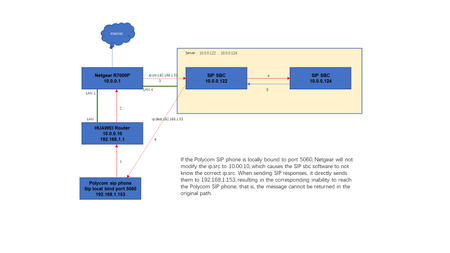

Hello everyone, I am developing a VOIP software system and I have noticed an issue: the Netgear R7000P router does not modify the value of the ip.src field of the UDP message when forwarding SIP (UDP). The specific situation is shown in the following picture:116Views0likes5CommentsNetgear R7000
