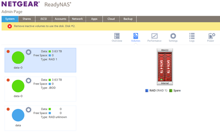

Hi all, Hopefully someone out there will have the expertise to help me recover my data. I have a RN 422 with 2 x 4TB drives running in Raid 1 configuration. All has been good until a month ago it started playing up. Failing to boot and an error message on the screen. After some investigation by myself I purchased a replacement drive fitted it and powered on the unit. From what I have learnt now I believe I did the wrong thing. I have not been able to access my data for about a month now and don't have a back-up. I thought Raid 1 ensured a back-up (mirror) but I have since learnt not. This is what I can see if I log into my NAS. Disk 1 is the original and Disk 2 is new blank and formatted.187Views0likes2CommentsRN 10400-100 EUS Volume Not Accessible
