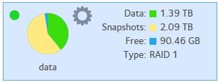

Hi Everyone, I noticed that i was running out of disk space on my ReadyNAS, and when i checked i found that Snapshots were taking up over 2TB. I went into the settings for that folder, and noticed this. So even though the folder thinks there's over 2TB of Snapshot data, the number of snapshots is zero. If i look at the timeline i also don't see any Snapshots. Also, if i navigate to the snapshots folder it's empty. These are the settings... (Note : I changed the snapshot schedule to Never in the hope i could reclaim the space. It was set to weekly before that). So my question is : Where is this data hiding, and how can i delete it to reclaim the space? Cheers, Andy3.8KViews0likes12Comments
