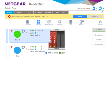

I had previously posted this thread Remove inactive volumes to use the disk. Disk #1,2,3,4. troubleshooting | NETGEAR Communities but I had to wait for replacement disks that i bought during the summer. Now I started the ReadyNas 104 and I see error "Remove inactive volumes to use the disk. Disk #1,2." In the previous post it looked like disks 3 and 4 were ok but now i dont see them in the volumes section Given the different status I have not tried yet to enter in support mode and do any other steps. I looked at logs and given there might be some personal info i am not sharing them all but smart, kernel and some other that look relevant but I dont really see any new logs. Logs https://www.dropbox.com/scl/fi/y9g7g67rjjvhr7bktb3n8/System_log-nas-bizmate-20250925-093830_reduced.zip?rlkey=rogb99pwsqp9r2143vtovqwmr&dl=0 Should I go ahead with the previous instructions given that only the 1st and 2nd drive actually look alive?651Views0likes20Comments
