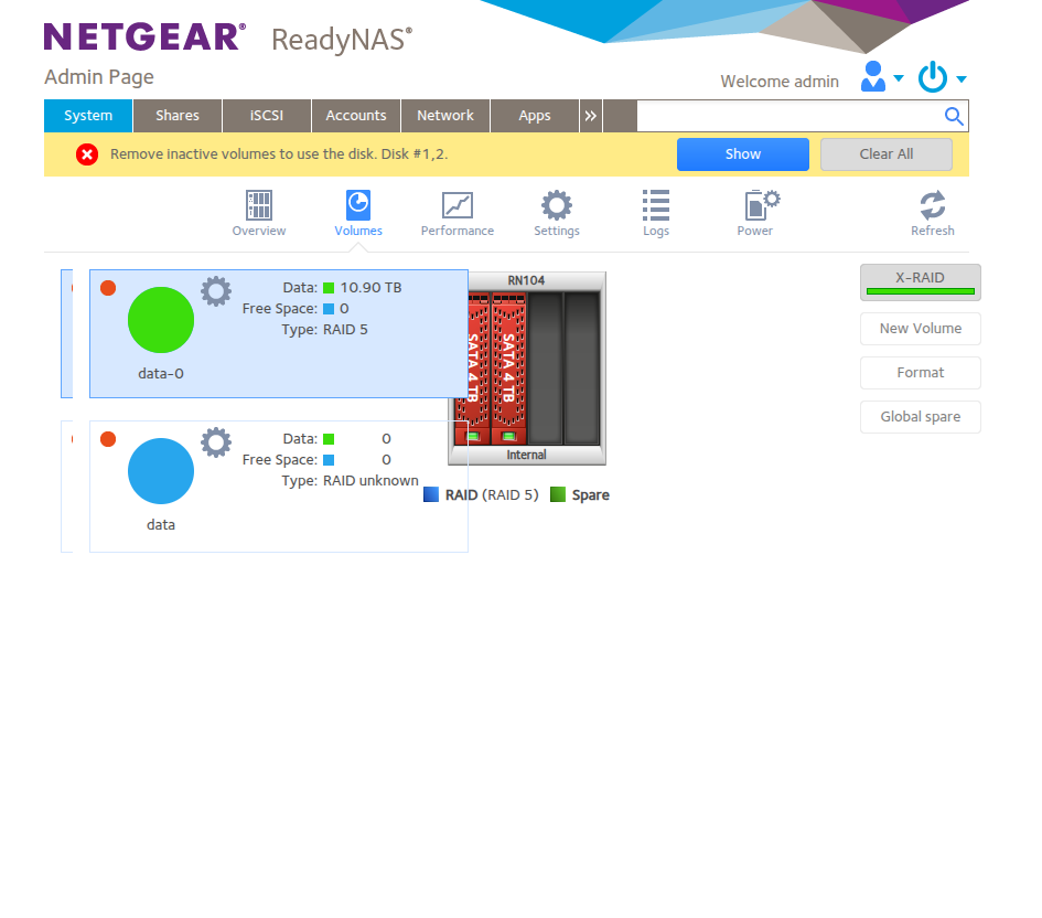

Remove inactive volumes to use the disk. Disk #1,2. troubleshooting
I had previously posted this thread Remove inactive volumes to use the disk. Disk #1,2,3,4. troubleshooting | NETGEAR Communities
but I had to wait for replacement disks that i bought during the summer. Now I started the ReadyNas 104 and I see error
"Remove inactive volumes to use the disk. Disk #1,2."
In the previous post it looked like disks 3 and 4 were ok but now i dont see them in the volumes section
Given the different status I have not tried yet to enter in support mode and do any other steps. I looked at logs and given there might be some personal info i am not sharing them all but smart, kernel and some other that look relevant but I dont really see any new logs.
Logs https://www.dropbox.com/scl/fi/y9g7g67rjjvhr7bktb3n8/System_log-nas-bizmate-20250925-093830_reduced.zip?rlkey=rogb99pwsqp9r2143vtovqwmr&dl=0
Should I go ahead with the previous instructions given that only the 1st and 2nd drive actually look alive?

  • StephenB's avatar
    StephenB
    Are all the original disks installed?  The NAS isn't detecting the last two (dmesg, disk-info, etc aren't showing them).
    If they are installed, then try powering down the NAS and removing all the trays.  Then re-insert them and power up.
    The only way that would work is if the NAS detects all the drives in tech support mode.  Possible, but not likely.
