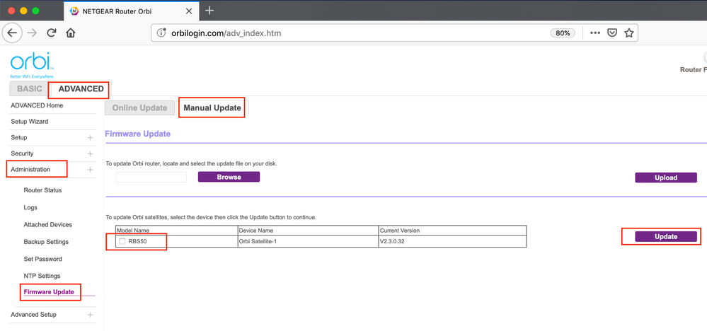

For future reference, I believe the correct practice is to update the satellites first and the router last. I also seem to remember there was a way to skip the password change, although Netgear certainly made it not obvious.
- When you click on that it prompts for password. This is if you do manual update.
I am using the web as well.- plemansGuru - Experienced UserNext step would be to factory reset the rbr50 and resync during setup as the satellite should be syncing from the main unit.
