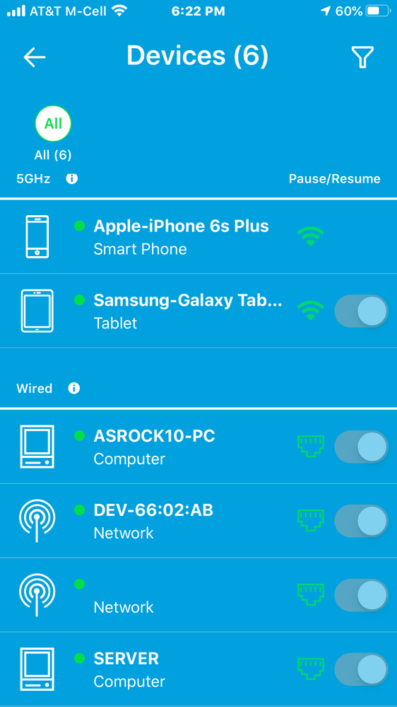

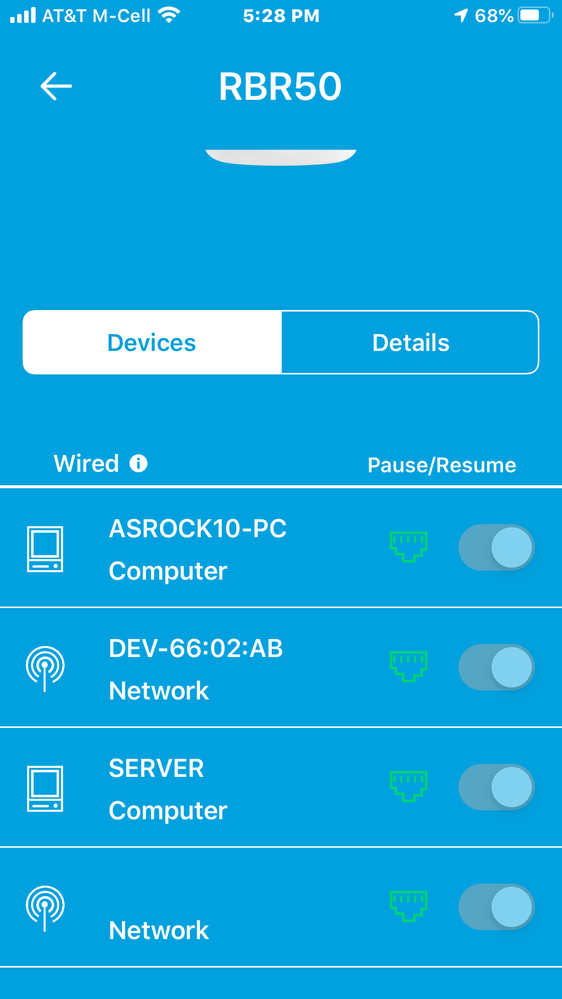

I checked mine this weekend and didn't see any issues with an iPhone and Android pad connected to the RBS while in the same room with the RBS. Devices seen on the app.
v2.5.1.8 loaded on both. AP mode.
