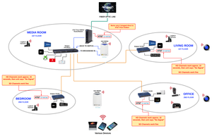

When connected through my Orbi RBK50, my AT&T Uverse cable is not working. Does anyone know how to get all Uverse receivers working properly with the Orbi router (NOT in AP mode) based on the setup b...

FURRYe38... My apologies if I wasn't more clear re the specific issue...
Other than my Uverse cable TV not working, my Orbi network is functioning very well. The Pace router/modem has delegated network management to Orbi and all of my internal IP addresses are 10.0.0.X.

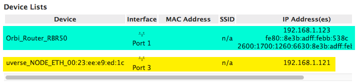

I've attached a device list from my Pace router/modem - the router is listed as it should be (I'm assuming). The "uverse_NODE..." is the Uverse receiver in the Media Room connected directly to the Pace (only possible to do this in the Media Room). Since it's connected to the Pace it's working fine.
Also attached a partial device list for the Orbi. As you can see, most of the devices I reference on the Network Map are shown here. The devices highlighted in yellow are the other Uverse receivers in the other rooms that are not working.
Let me know if any addt'l info will help you to help me! Thx!!!!
