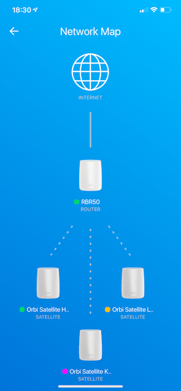

I attached some screenshot. Please not that the "Kitchen" satellite on the picture is turned off but I could turn it on (just don't really use it.)

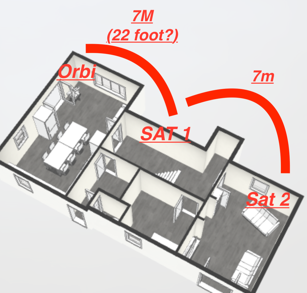

        yes thanks, but I dont get how the system believes that connecting both to the main AP.
        the last AP can't possibly have a better link with the main AP than the middle satellite due to its emplacement:
        main orbi > 22feet in a straight(ish line) then > satellite 1 > 22feet satellite 2

        Model Name Device Name Current Version Status
      Router RBR50 RBR50 V2.3.1.44 No new firmware version available.
      Satellite RBS50 Orbi Satellite Hall V2.3.1.44 No new firmware version available.
      Satellite RBS50 Orbi Satellite Kitchen V2.2.1.210 Waiting for connection
      Satellite RBS50 Orbi Satellite Living V2.3.1.44 No new firmware version available.
      I'm not sure about the total house sq / feet, Although I know that RBR50 > Orbi Satellite Hall = 7m (22feet I think) same from  Orbi Satellite Hall >
      Orbi Satellite Living. Also not sure that does anything but they all by windows.

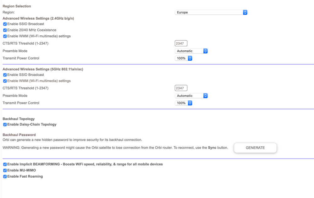

      Orbi is in AP mode, Settings :
      20/40 MHz Coexistence, e WMM (Wi-Fi multimedia) settings, CTS/RTS Threshold 2347, Preamble Mode auto,Daisy-Chain Topology, Implicit BEAMFORMING,  MU-MIMO, fast Roaming
      2.4ghz chanel : auto, 5ghz :36 using WPA2-PSK [AES]

        22 feet is a bit too close between the case RBR and satellites. 30 feet is recommended in between them to begin with depending upon building materials when wirelessly connected.
        Also daisy chaing needs the placement of the satelites to be out in a line from the RBR and following satellites place after wards so they can piggy back of each other. The RBR being at the start of the line and the last satellite being at the far end.
