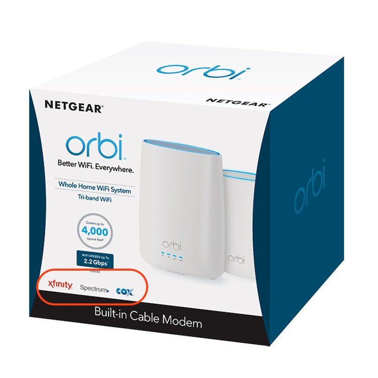

The Orbi retial box posted on the Netgear site (and other retailers like Amazon) clearly shows the "official" Spectrum logo and NETGEAR claimed they would support/partner with my Spectrum (TIme Warner). In fact, I recently listened to a podcast in which an Orbi product manager and an engineer both mentioned Spectrum as a vetted/supported ISP.

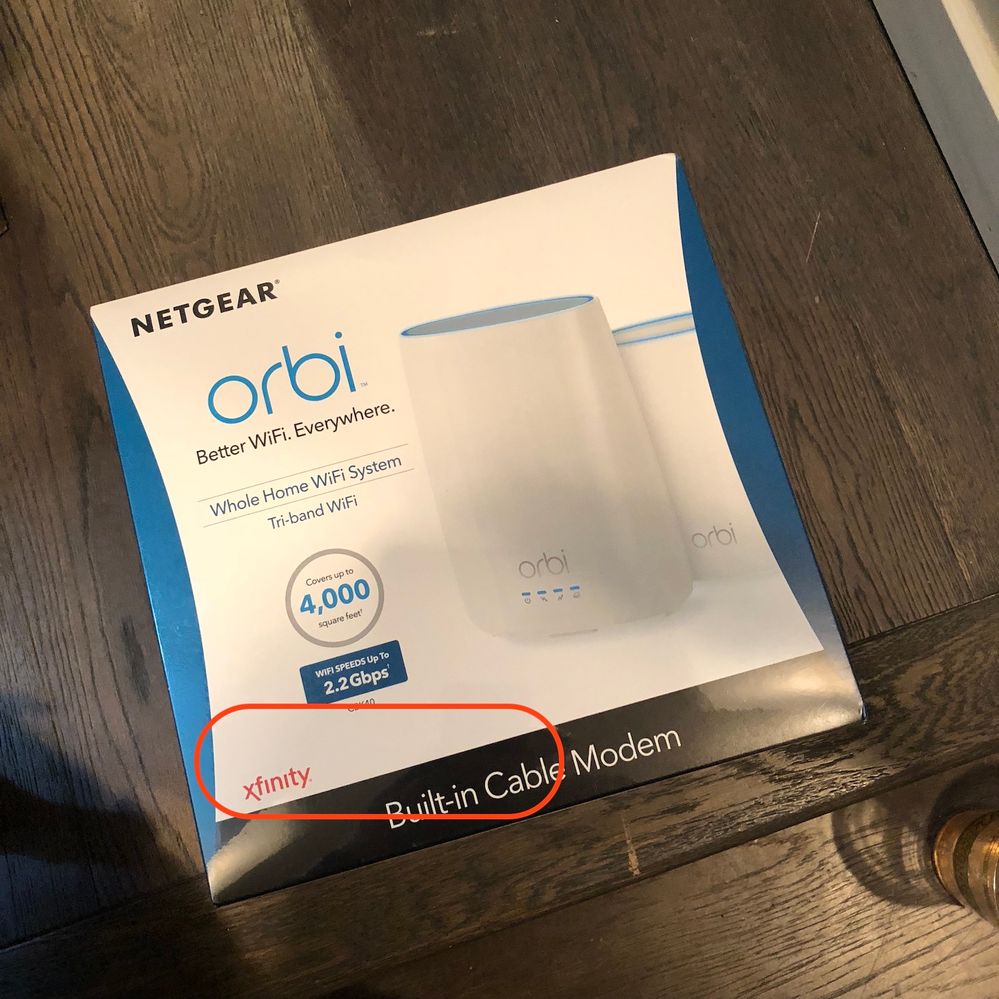

When my Orbi CBK40 system arrived - POOF! - The Spectrum logo was GONE. The Spectrum logo is no longer displayed on the Orbi's physical retail box. The only ISP explicitlry mentioned is Xfinity.
I opened the CBK40 box and read the directions. No mention of any ISP except Xfinity. I remained cautiosly optimistic and proceded to set up and activate my new CBR40 modem. FIngers were crossed...

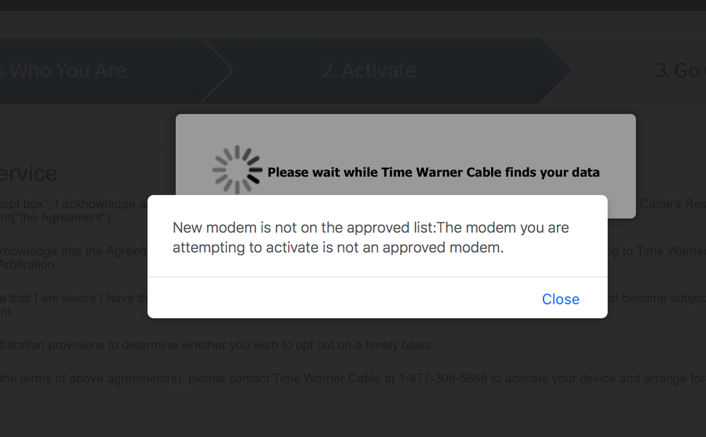

Alas, as suspected. I was unable to activate my Orbi CBR40 modem/router with Spectrum. The CBR40 is not on the Spectrum "offically supported modem" list. Activation failed.
