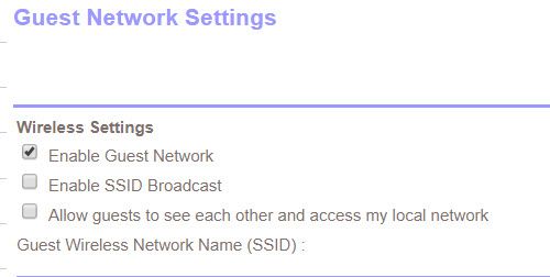

I plan on putting the RBS50 (the satellite) in a family room / living room area.  Guests would be able to access the internet through Guest-Mode Wireless.  I want to prevent guests from being able to get onto my LAN by simply plugging in a LAN cable into the RBS50.  Is there a way, in the firmware, to disable the LAN ports on the RBS50 ?  How can I get around this problem without using something like an RBW30?
