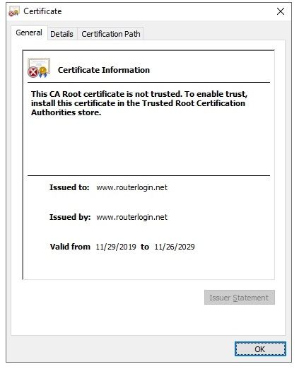

Update the web server certification of RBR50/RBS40 - Wire1852Apprentice

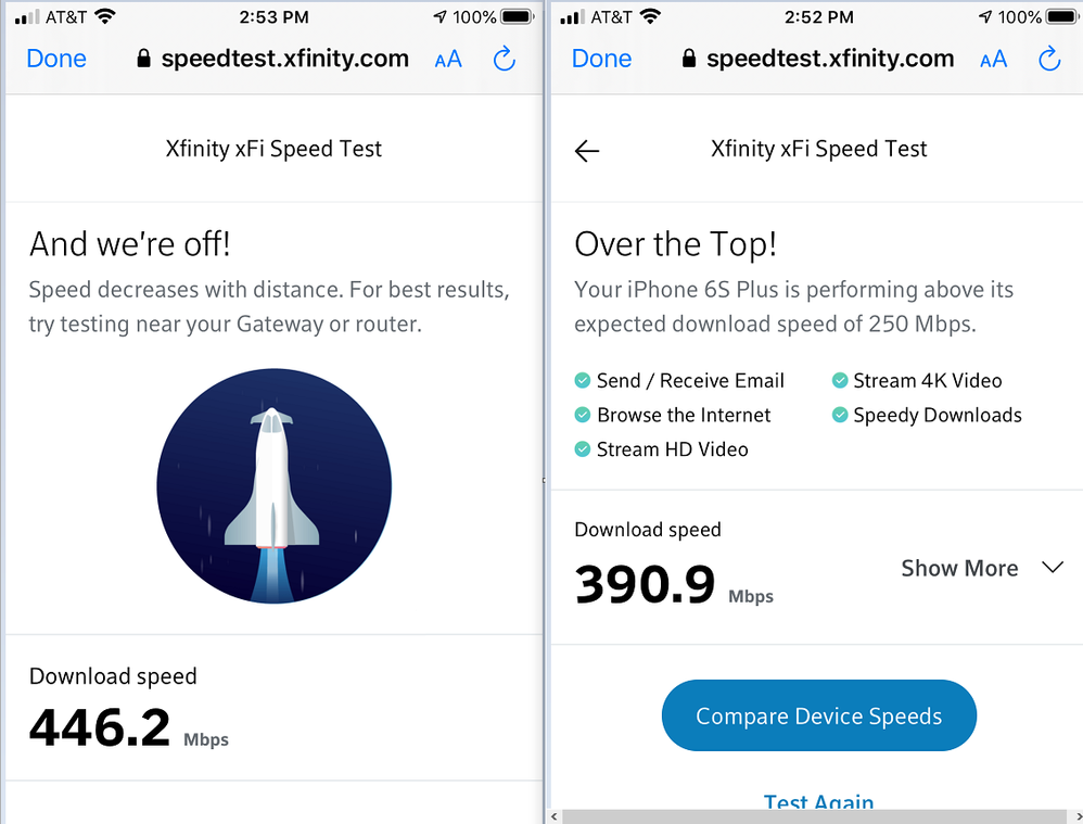

So 2.5.1.8 came out, waited a few days read what appeared positive results. UGGG.
Positives - Performace does seem to be back up - note this isnt anything better than long ago firmware, but better than the last few iterations. Devices on Sweet Spots back up to 300-500mpbs range. Speedofme showing consistent MAX DL/UL on clients in several locations in my home. My max is about 125DL/8UL which is my broadband limitation. And that will do it for positives.

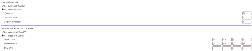

2nd - This is not specific to this software just fed up with this no longer working for over a year - using manual DNS servers with DHCP for ISP hasnt worked for a very long time. The option is grayed out if you use DHCP for the WAN/ISP address. I use to use DHCP for WAN/ISP and still was allowed to use DNS custom settings.

I can select "Use These" from the Internet Setup section and there not grayed out for me:

And here we are in mid December with Version 2.5.1.8 and the security certificate has still not been fixed since Aug 2019. Chrome, Firefox & Microsoft Edge all indicate the certificate is not to be trusted.

Saw same after loading this new version. No issues now with device naming or certification.
