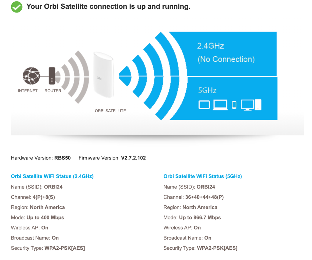

    • belsokary's avatar
      belsokary
      When I try to connect directly to the Satellite IP address, I get the following status.  If I try to connect direclty to the other satellite, it doesn't connect at all....I can't wire the router directly to the satellites, but go back through a centralized switch, should that be ok?  If so, I can try disconnecting and syncing direct through wireless first again I suppose.

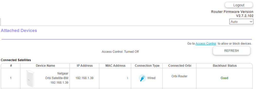

      Just wanted to provide full details in case someone else finds it useful:
      Hardware List:
      - Orbi RBR50 Router, Firmware v2.7.2.102
      - Orbi RBS50 (x2), Firmware v2.7.2.102
      Internet/Wiring Setup:
      - Internet Via Frontier Fios, skipped over the Frontier Modem and routed directly to the RBR50 Router using the "internet" port (yellow port on far left)
      - Connected a Router ethernet port to a Gigabit Switch (TP-Link 8 Port GigabitEthernet Network Switch (TL-SG108))
      ack.
      - I had to reset Satellites to Factory, and re-establish the backhaul connection first however prior to wiring to the switch.  I synced over wireless, and verified the backhaul wireless connection was successful.
      - I then ran ethernet connections from the Gigabit Switch to the RBS50 satellites.  Within a few minutes, the router correctly configured to a wired connection (see screenshot)
      All is working as desired now!
      Thanks for all the help!
