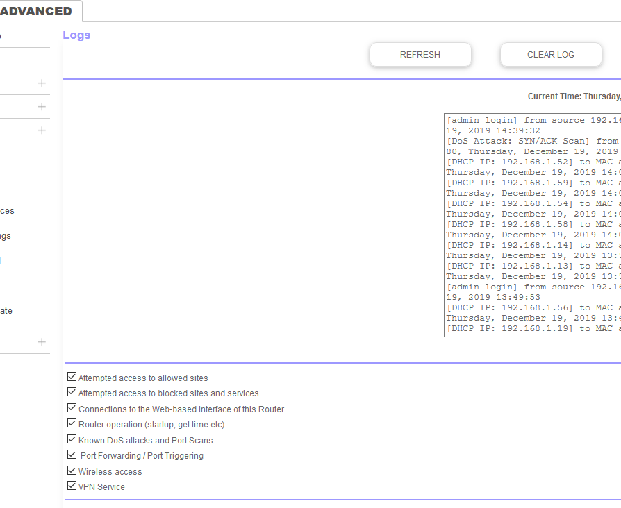

        It is the logs from the Orbi.
        Well, damn.  I have collected the entire Orbi log starting last March, and I have collected no records like these.  I thought that my log was set to record everything possible.  What must be set to get these items in the log?  Here's what my log setup looks like now:
