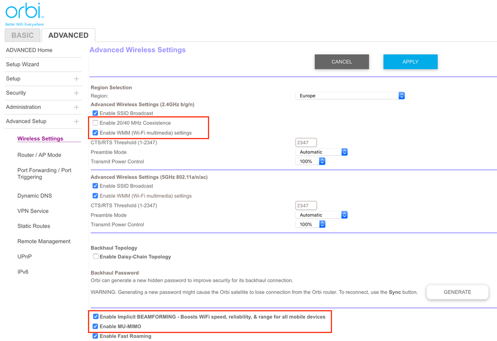

    The following parameters affect the 2.4 GHz throughput. All found under advanced wireless settings:
    - Disable the 20/40 MHz coexistence to only have 40 MHz bandwidth channels on 2.4 GHz band
    - Enable WMM to prioritize multi.media packets (audio and video)
    - Enable Implicit Beamforming to boost wifi range
    - Enable MU-MIMO to enable multi spatial streams if the device supports that.

      MU-MIMO dos NOT affect the 2.4 GHz throughput.
      • ekhalil's avatar
        ekhalil
        Master
        Thanks, you are absolutely right. 2.4 GHz supports only SU-MIMO and not MU-MIMO. This parameter in the advanced wireless settings in the web GUI is only for MU-MIMO. I confirmed this by checking the config parameters:
        wla_mu_mimo=1
        wlg_mu_mimo=1
        wla_2nd_mu_mimo=1
        So this parameter only affects the 5Ghz channels for the fronthaul's main wifi channels (wla) and the guest wifi (wlg) and has nothing to do with the 2.4GHz channel (wl). :)
