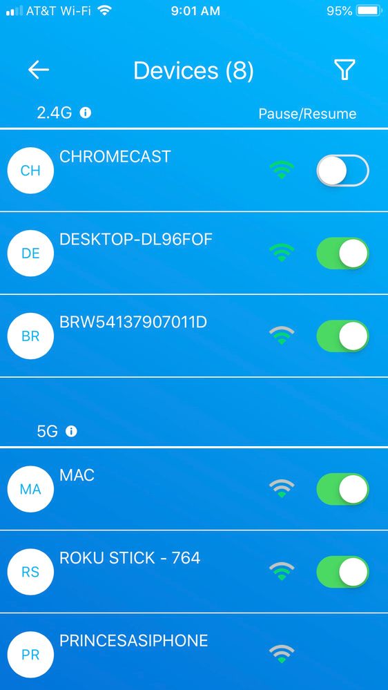

I did not know much about using the 5 ghz, so we have not connected any of our devices to that wireless.  BUT- using the Orbi app, I see multiple devices connected to the 5ghz wireless. For example, my phone. My phone settings say it is on cardinal, not cardinal-5. The Orbi app says it is on the 5. Screenshot attached.
Question 1- Why is the device list showing that things are connected to the 5 ghz network when I did not change any settings?  Is that an important thing?

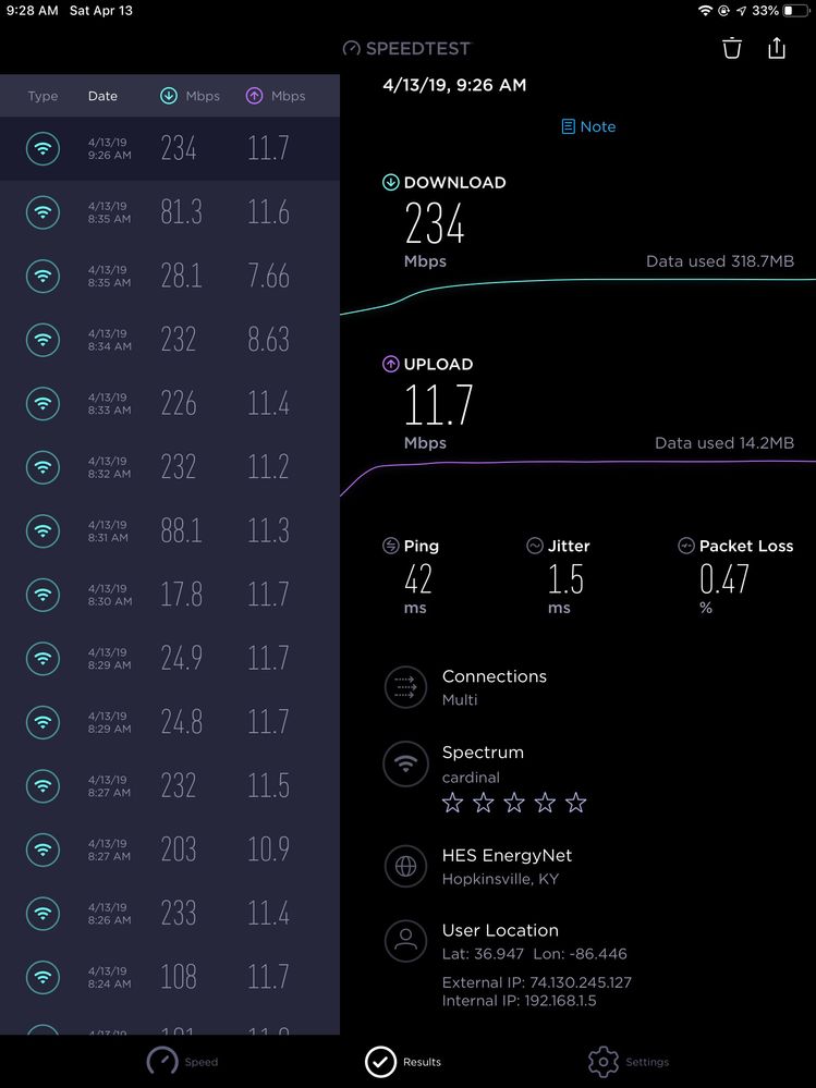

This is an example of how inconsistent our wireless is- 30 minutes ago we tested the speed of each quadrant of the house. The speeds everywhere were normal. 10 minutes later the wireless speed dipped to a quarter the normal speed.  See attached

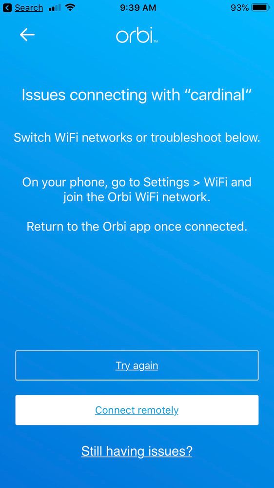

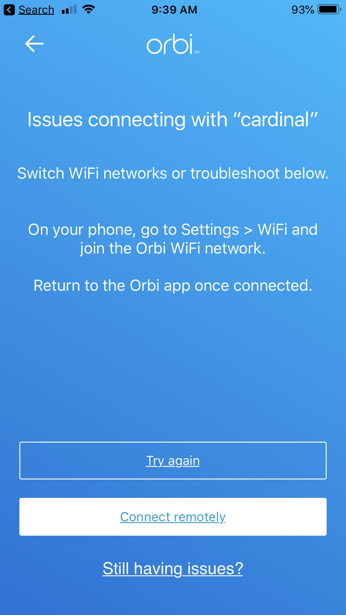

While composing this message I checked my Orbi App. It said it couldn't connect with the Orbi's. See attached. 5 minutes later it asked for the password and logged in. If I knew about this stuff it wouldn't frustrate me as much.
