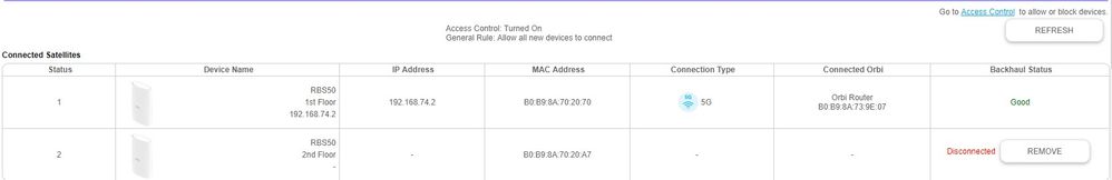

- Cannot disable daisy chain because it will effectively set the connection to the farther satellite to poor instead of good.
- If I use wired backhaul to the farther satellite (which was working fine with the OnHub mesh) everything goes haywire and gets even worse.

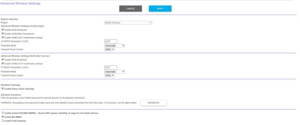

- I have daisy chain topology and MU-MIMO enabled, everything else is disabled.
- The farther satellite regularly just disconnects and I have to climb to the 3rd floor to turn it off and back on:

- Enabled, and then disabled, implicit beamforming (most our devices can handle that)

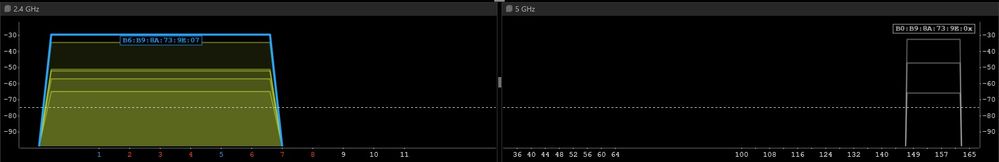

What channels are you using? Auto? Try setting 1, 6 or 11 on 2.4Ghz and any unused channel on 5Ghz.

TC8717=hardwired>RBR50=Wireless>RBs50x2 (Just removed the daisy chain topology and changed to star topology)
I do have 1 8-port unmanaged switch to LAN 2 port in the RBR50, and all my main devices pluged to it (TV, PS4, Xbox One S, Wink 2 hub, Amazon Fire TV, FingBox, Obihai VOIP box, QNAP NAS), plus the Cat6e wire that runs to the 3rd floor, but it is currently unplugged from the second (farther) RBS50. My router is in the basement, the first satellite is roughly 25 feet from the router, and the 2nd satellite is just 45 feet from the main router and 20 feet from the 1st satellite. The stairs from basement to 2nd floor are completely open, no walls in the middle, so the signal goes straight to each satellite.
So far, with the star topology I'm showing a good connection to both satellites.
I will move to channel 1 on 2.4Ghz, disable MU-MIMO, as you mention in the setup you did for your friend, and leave it there for 24 hours and come back with the results.
