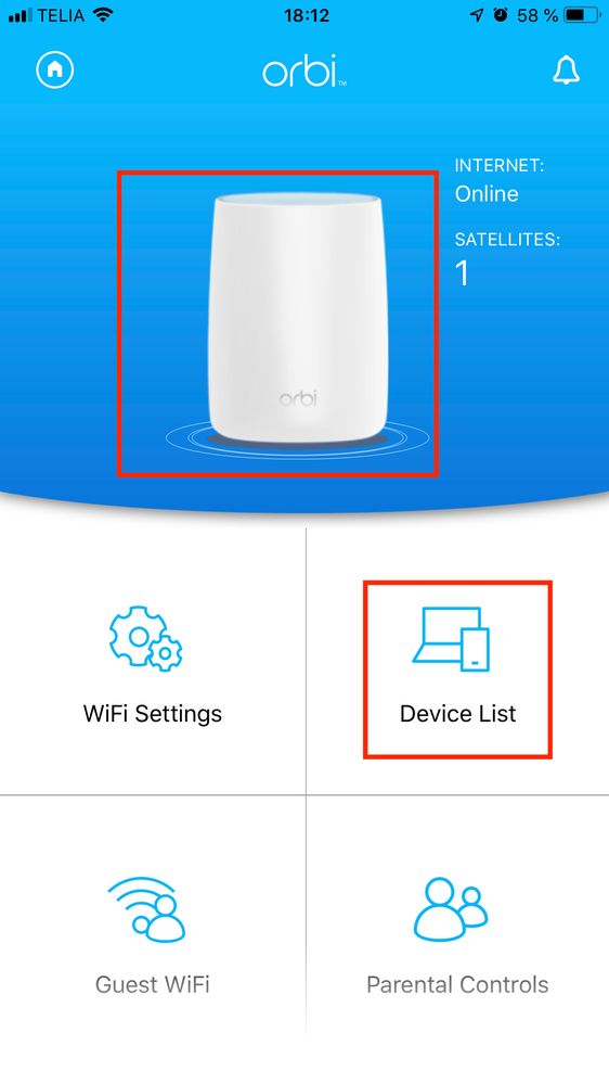

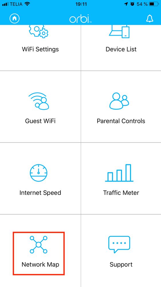

  • Please note that -in the Orbi app- you can access the device list either using the "Network Map" or by going to the "Device List", see below:
    If select the "Device list" and then when you get the list you pull down the list then the device list will be updated. Have you tried that?
