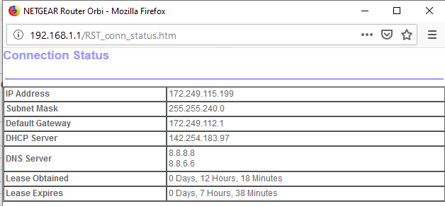

    The next time this happens, can you go to the Orbi web interface, the Advanced Tab, and click on the "Connection Status".
    What does it show for the DHCP lease?  Here's mine:

      Hi
      the values I have now are the following, and if I remeber correctly, I see similar ones when the issue occures (maybe the exipration is a bit higher, like 26 min):
      Lease Obtained 0 Days, 0 Hours, 30 Minutes Lease Expires 0 Days, 0 Hours, 22 Minutes
      • CrimpOn's avatar
        CrimpOn
        A 30 minute DHCP lease is VERY short. I would call the provider and ask, "WFT?"
