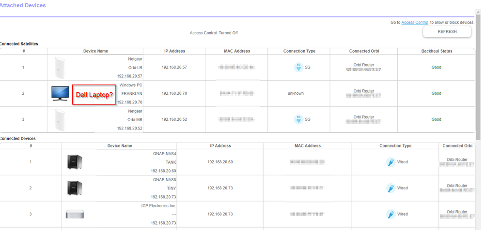

- JMU1998Luminary
Just curious if Eero or Velope have similar issue not able to accurately potray what devices are connected to which unit correctly
- CotedanApprentice
I’ve tested the Velop and can’t remember having problems identifying which devices connected where. 2.1.1.16 in Orbi does not identify what speed nor node devices are connected to.

- JMU1998Luminary
Did another factor reset, nvram clear and fresh install of v2.1.1.16 for both base and satellite and manually entered settings and fresh reboot and about 2 hrs later all devices show connected to the base and none of the satellite!!
- aazVirtuoso
JMU1998 wrote:Did another factor reset, nvram clear and fresh install of v2.1.1.16 for both base and satellite and manually entered settings and fresh reboot and about 2 hrs later all devices show connected to the base and none of the satellite!!
That is a known issue in this and the previous firmware - the devices will show as connected to the router even when they are connecting through the satellite. They are working on putting out a fix for that soon.
