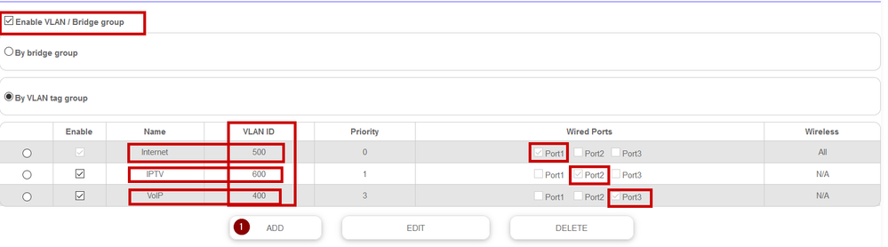

if anyone is coming here and have trouble to set up the orbi with unifi can follow the below steps,
1. set up the orbi in router mode
2. go to advance > Internet > set the service provider "PPOE" and enter the username and password provided to you by unifi
3. go to Advance Setup> Vlan / Bridge connection
4. enable the vlan/bridge
4.1 click add button and add all the options, in this way only port 1 will get the internet. you can choose if you want other ports also have the internet
5. after each add orbi has a small bug and everything will become hidden again. you need to click "enable VLAN/Bridge group" again. when you are done with all the setup click apply. orbi will reset.
that's it all
orbi unifi vlan setup
