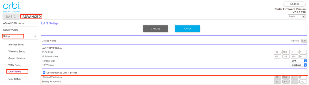

    Do you have access to orbilogin.com? If yes, which IP range do you have assigned for DHCP, you can check it as follows:
