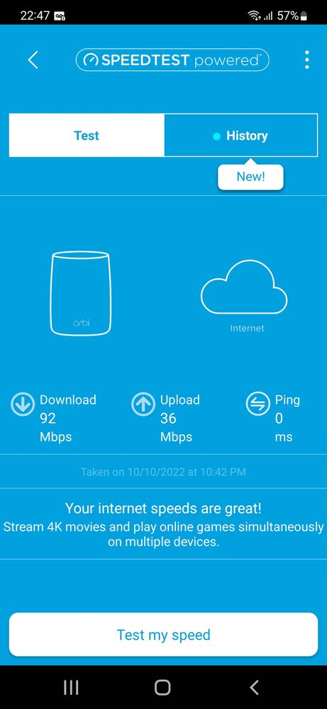

I have been limited to 100MBPS package but just upgraded to the 350MBPS package.
My PC which is plugged directly in to the ethernet is flying at top speeds but the wifi in the house is still limited to 100MBPS.

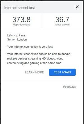

  • Just as an update, if I link to the Virgin wifi then I do get massively high speeds over 300MBPS but the reason I have the Orbi because the Virgin range is rubbish!

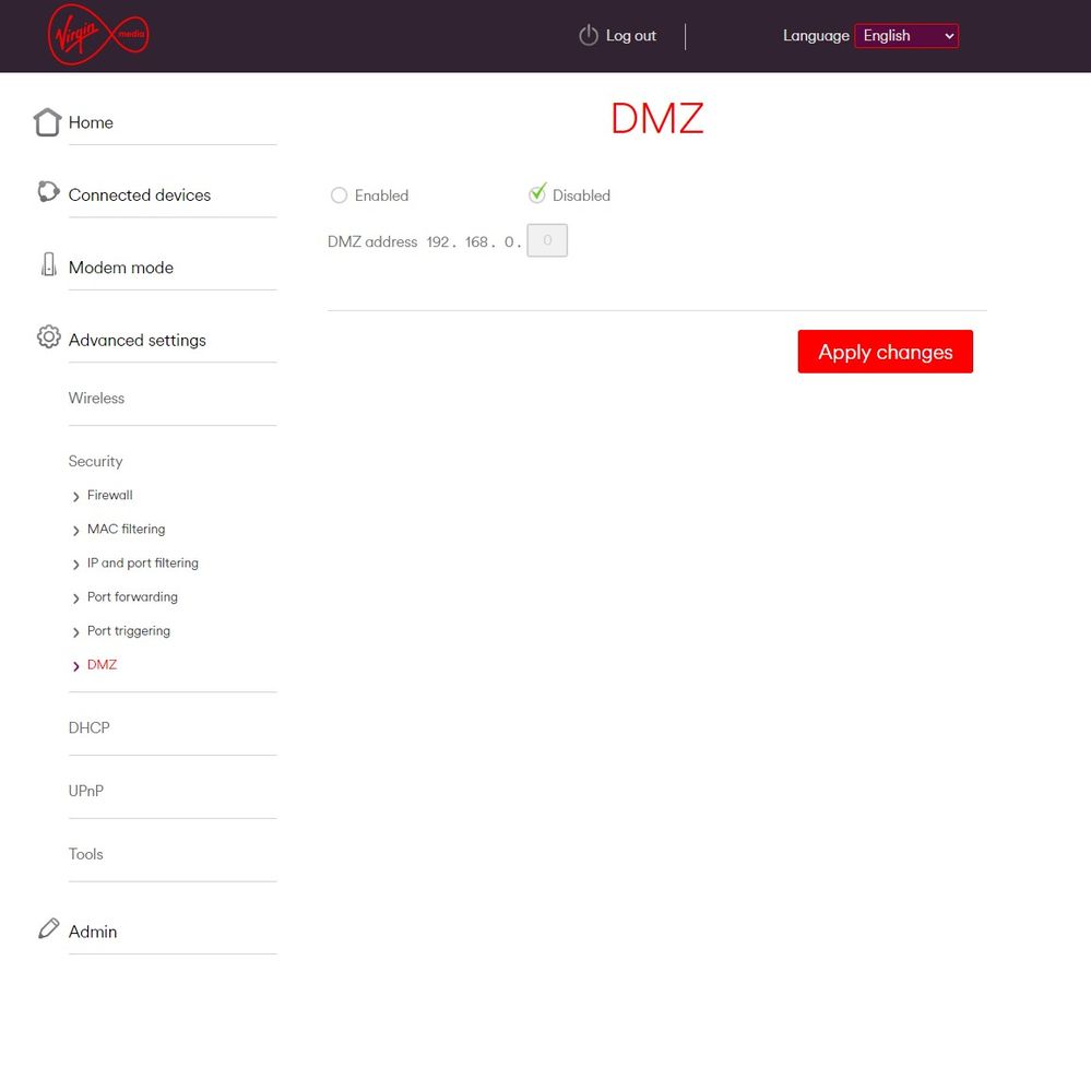

      Really sorry but I am a novice - I have found the Virgin DMZ below.
      When you say 'configure the modems DMZ/ExposedHost or IP Pass-Through for the IP address the Orbi router gets from the modem.'

        For use of the DMZ, input the IP address the RBR gets from the modem. You'll see this on the RBRs web page under the Advanced Tab/Internet section near the top right. Put this address where you see the DMZ address on the modems web page you posted here.
