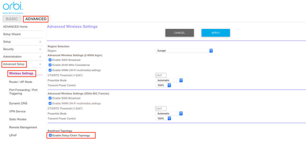

        You can find the Daisy Chain settings here:

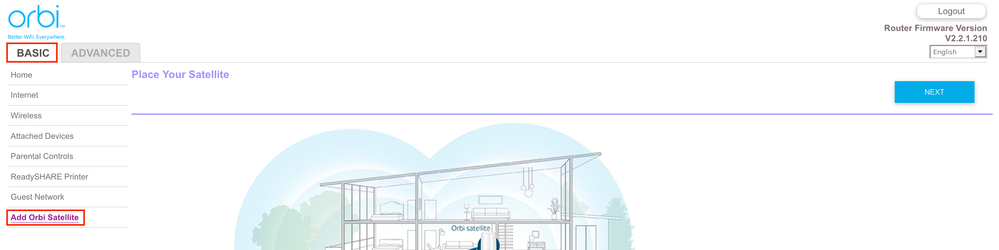

        Please note that you need to press the Sync buttons on both router and satellite to make them look for each other? You can also use the "Add Satellite" procedure in the GUI as follows:
