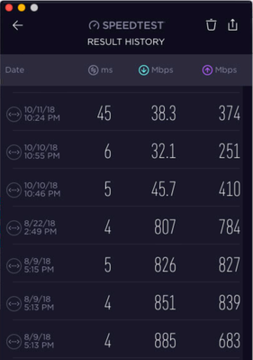

My system updated automattically this week from 2.1.4.16 to 2.2.1.210. I have ATT Fiber and would normally get 800/800 before the upgrade. After the upgrade my up/down is 30/300ish. I connected my computer directly to the ATT Router (Pace 5268AC) and got 800/800 again. I have attempted to downgrade back to 2.1.4.16, but after every downgrade, the system automatically upgrades back to 2.2.1.210 before I'm able to test.
The ATT Router is set to passthrough to the Orbi. This issue just appeared after the latest upgrade. I attached a speedtest screenshot to show the drastic performance drop.

Neither the factory reset with no config changes after boot or the manual code push made the speeds any better. I'm still getting about 30-50down/300ish up. This is on the wired connection to the orbi. A wireless connection to the ATT box is giving me 100down/100up. The wired connection to the ATT box gives me 800/800.
